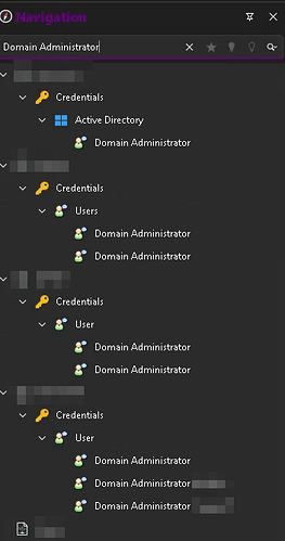

The Inconvenience arises when you search for a specific credential, lets say “Domain Administrator”.
To be clear, the search function does provide the credential I was looking for (especially when you have fuzzy search on) but it is quite inconvenient to scroll down to the 6. Document when I potentially have 15 open documents at once. (I Work for a MSP and therefore have many different customers each with their own document)

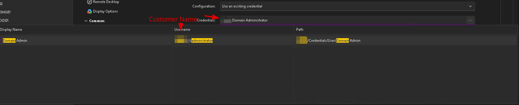

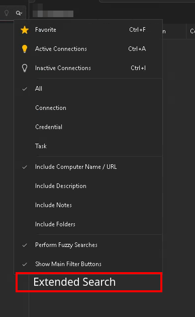

It would be Great to have a switch to toggle for “Extended Search” with the look and feel the “Use existing Credential” search already provides.

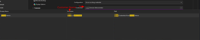

What I would expect:
What I get:

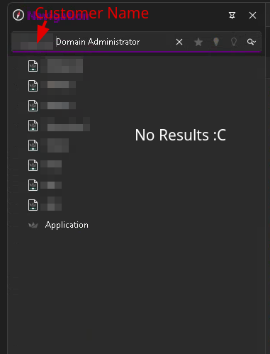

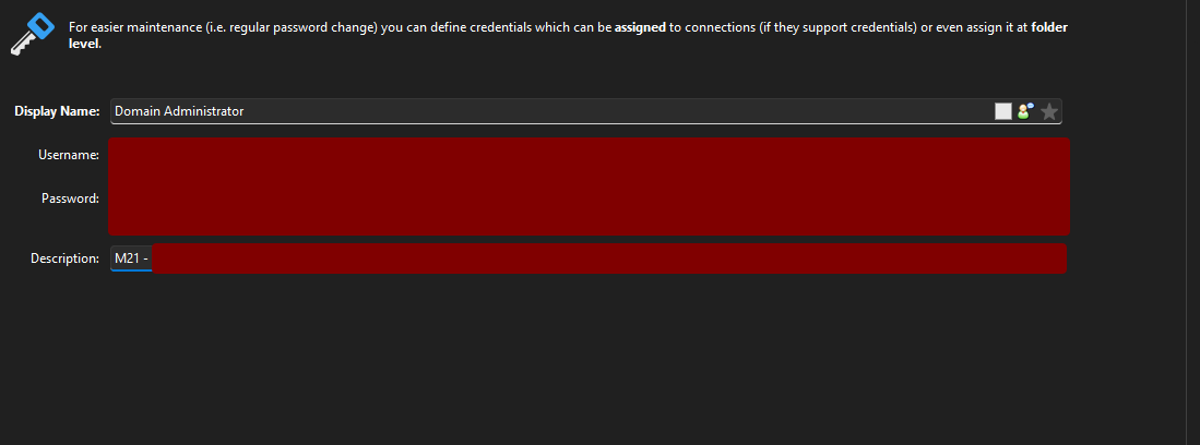

After testing the “tagging” option, I don’t think it will suffice for me.
It’s quite challenging for me to specify what the problem is, but from my point of view it seems as if the fuzzy search (or the entire search for that matter) has trouble searching for different attributes in one query.
I wrote a script to put the “Customer Code” in the beginning of the description.
So when I want to compose a query like “M21* Domain(…)**”
* Being the “tag” in the description
** Being part of the display name
I get no results at all.
Did I perhaps misunderstand your suggestion?
Regards
Gabriel

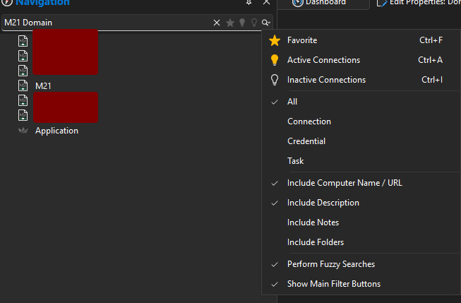

Hi Gabriel,
no, you didn’t misunderstand. I messed up and didn’t realize that the fuzzy search is only available on the name property. I mixed up “tagging” with fuzzy search. I’m sorry for the misunderstanding!
Tagging in the description field can be useful to have a couple of different search terms/tags and you can quickly filter by one of the tags using the search. Unfortunately there’s no and/or expression possible so you can only search for one tag at a time.
Making use of fuzzy search you need to prefix the Domain Administrator credential name with M21, like “M21 - Domain Administrator”. Then you could use fuzzy search to type “M21DA” or so, to quickly find the item.
