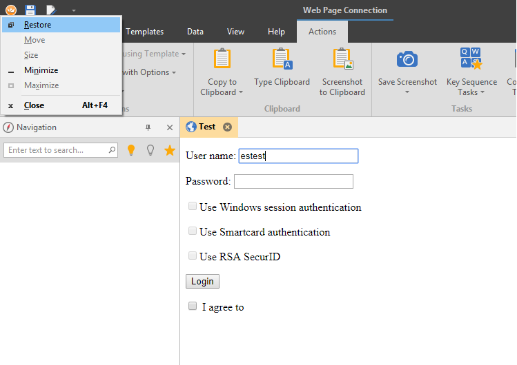

Still not working… here are some Steps to reproduce:
I’ve attached an example page to try. (copy of the vmware vCenter login page)

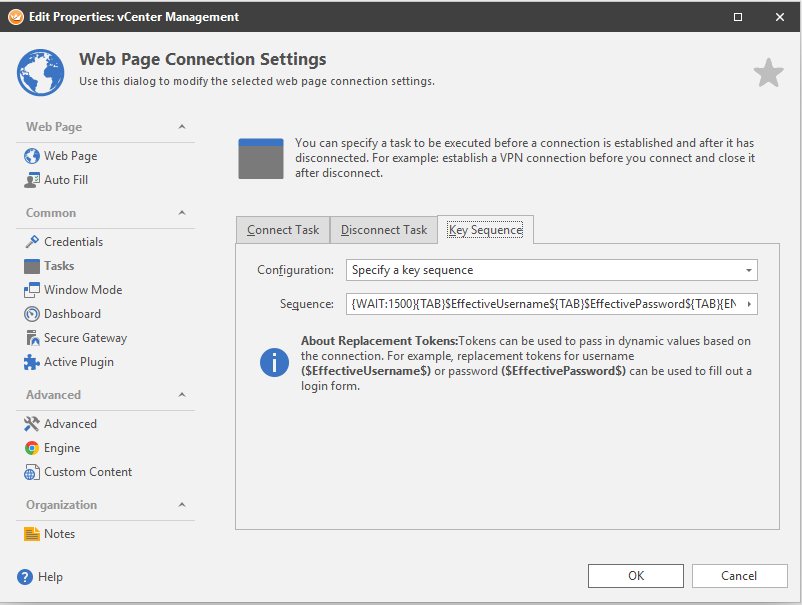

Autofill does not work for this page so I’ve created a Key Sequence:
{WAIT:2500}$EffectiveUsername${TAB}$EffectivePassword${TAB}{ENTER}
Username + Password is set set to “test”
Engine: Chrome (Dedicated, but non dedicated doesn’t work also)
The key sequence enters “estest” in the first textbox and then a context menu pops up on the top left corner of Royal TS. (see screenshot)

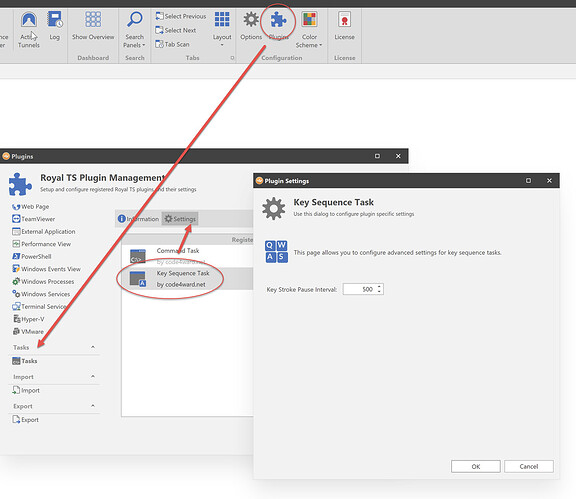

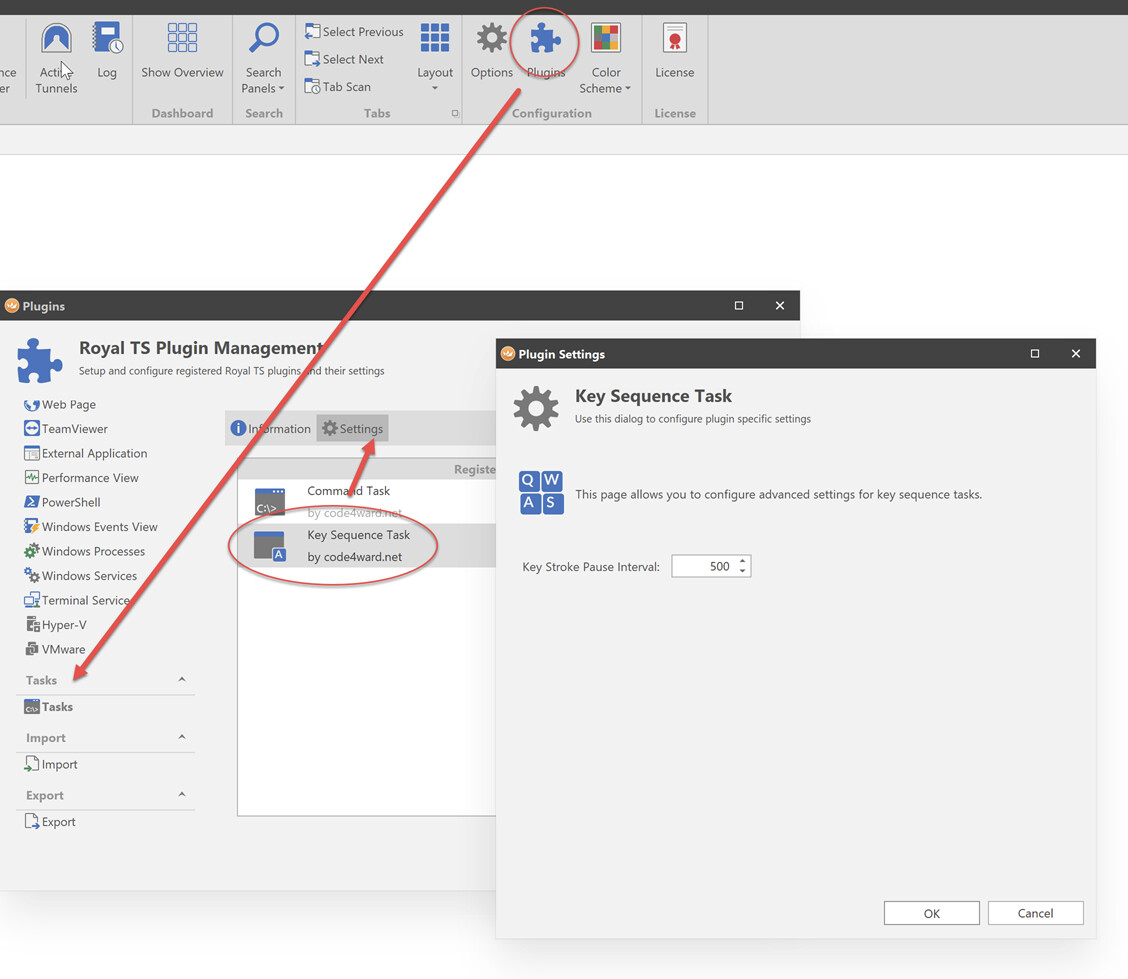

I just spend an hour to repro the issue on my side and I’m still not seing the issue. What I did notice is some weird behavior when I use the HTML page, Patrick provided in this thread. I think some javascript may interfere and the key sequence is executed too fast. Can you try to increase the pause between keystrokes in the plugin settings to the max. (500 ms):
Let me know if this changes anything.
The above suggestion did not change anything. The issue is that the enter key does not work, no matter how slow you make it.
Thank you very much for the suggestion. I increased the
keystroke pause interval to 500 for testing. Keystrokes did type much slower as
