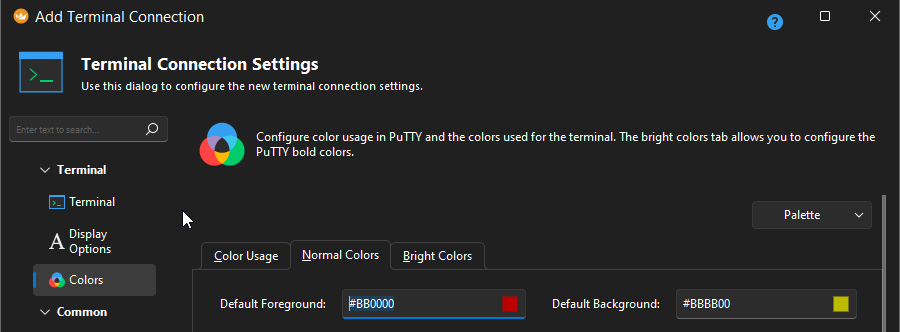

Regarding changing to Putty though, I have set the default Terminal plugin to use Putty. Set font/colors.
However, on a new connection of Terminal, it does inherit the Default Putty type, but not the fonts/colors settings. It is using an override of some sort, b/c the colors I set are red/yellow, but I can’t figure out why the Default Terminal override is not working.
Adding new Terminal connection (see colors it sets)
Showing Terminal override colors actually set:

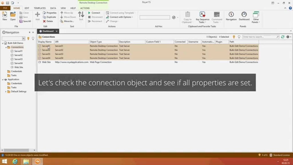

When you select a folder (or document) you can enable the option to show all objects from all subfolders to make it easier to bulk-edit all your objects in the document. I recommend you check out this videos:
Regarding the default settings: make sure you also switch to the PuTTY plugin in the default settings before you set any of the putty defaults. Then it should use the default settings as configured for new connections.
The bulk edit is working fine, but the issue is on adding a new Terminal connection.
However, I think this was my issue you mentioned:
I have redone the defaults in teh plugin for Terminal under Putty and it is working now. I sincerely appreciate your replies while I try to get a feel for the app coming from another app that no longer was working well for me.
