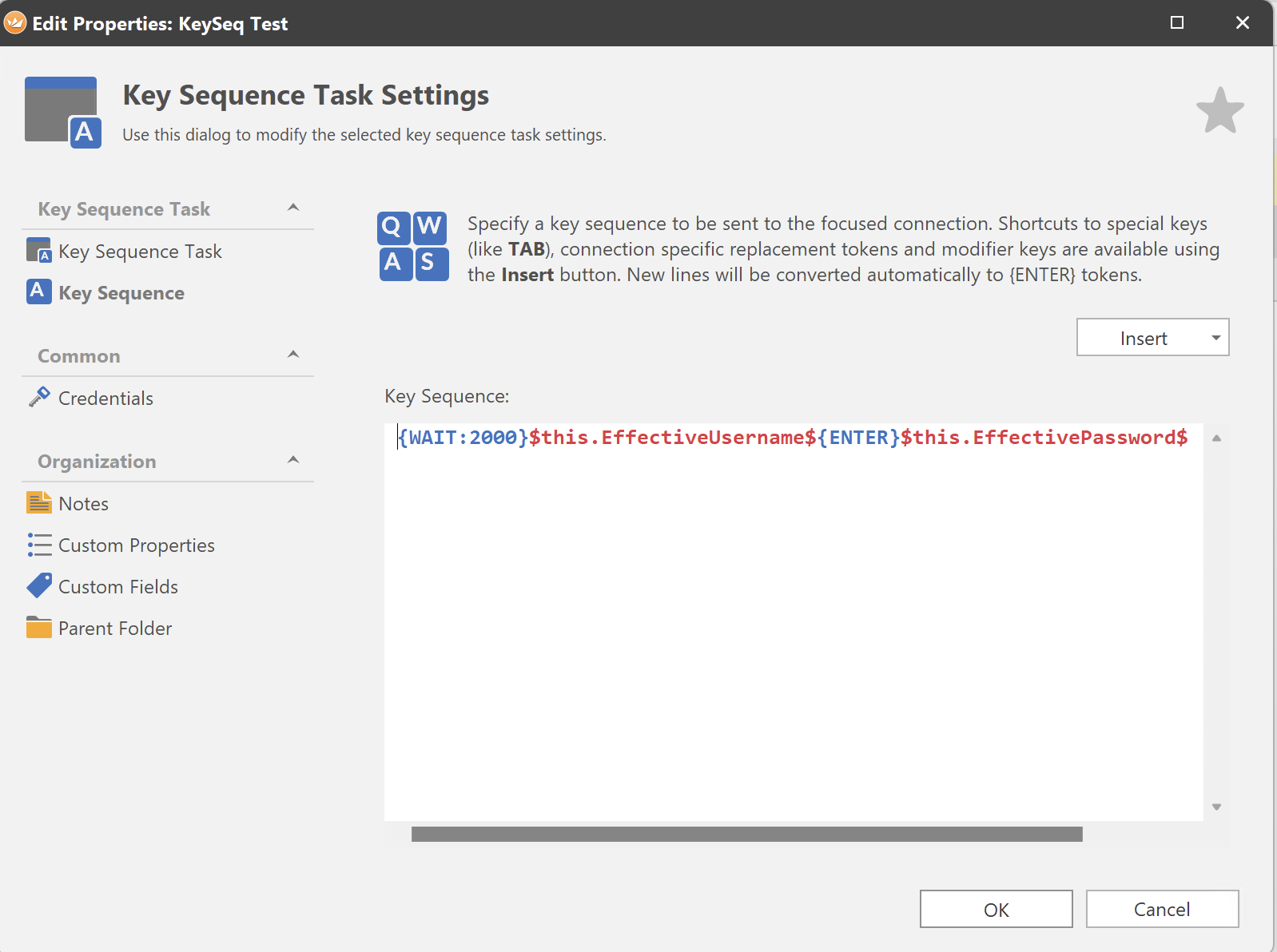

You create a key sequence task with the format/key sequence you want to cover. Like this:
Note that the tokens have the prefix “this.” which indicates to not use the context credentials, instead use the credentials of this task.

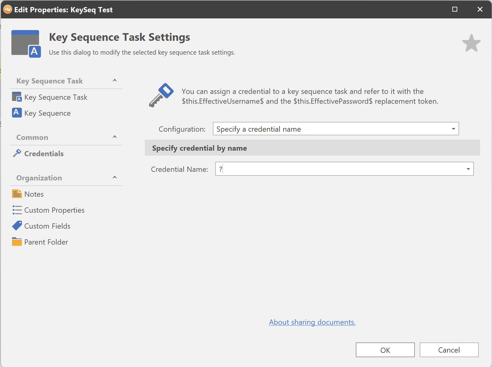

In the task credentials page you configure the credential like this:

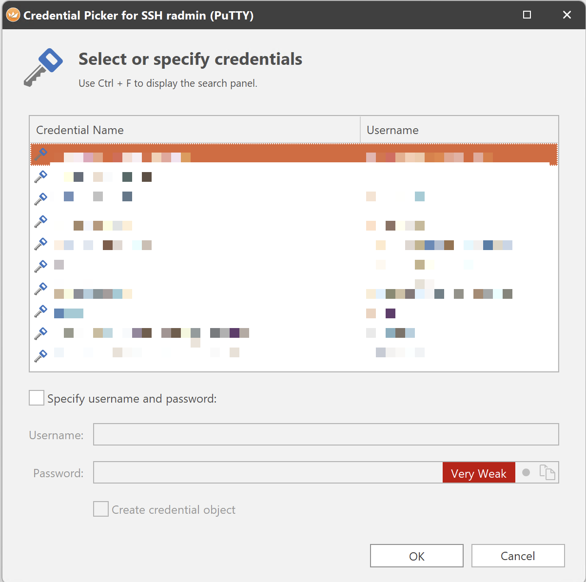

When a “?” is configured as credential name, we would show a credential picker (similar to the one we use in Connect with Options -> Prompt for Credentials):
In the picker you can quickly type/seach for the credential you want to use and after hitting OK, the key sequence with the selected credential will be executed against the currently selected and active connection.

Using the credential name approach would have a couple of benefits you already requested:
  • Setting the credential name to ? will always show the credential picker with all credentials
  • Setting the credential name to a name which can be resolved uniquely (only one cred exists with this name), will prevent the dialog from being shown and just use the found credential
  • Setting the credential name to a (fragment) of the name and more credentials are found, it will present the credential picker dialog with the specified name as filter and shows the results.
  • Lastly, if the credential name specified is not found, it will show the credential picker but pre-fills the user name with the specified name.
The behavior described above is already part of Royal TS where credential pickers are shown. So this would be all “for free” if implemented that way.
More complex search queries as suggested are currently not really possible and would need much more work in the underlying infrastructure. Sorry!

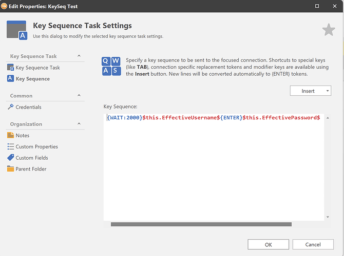

  • Also kind of related - in the beta, the Key Sequence tab of the Key Sequence Task dialog no longer colours the values in red and blue.

  • If you just start typing, this is the default behavior. If you want to filter the list, use CTRL + F to show the find panel. Typing there will actually filter the list. I’ve also added a note in the dialog for better discoverability.
  • Thanks for pointing this out. I have fixed that for the next release.
